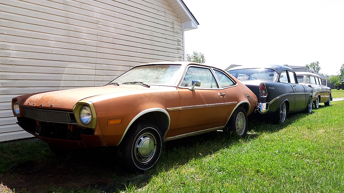

It was too dark when it was dropped off tonight to get my own pic, but this was just delivered today...
5 projects might be a bit much to keep up with, but...
I won't be touching this one too much until the truck is finished, but this one should be fun.

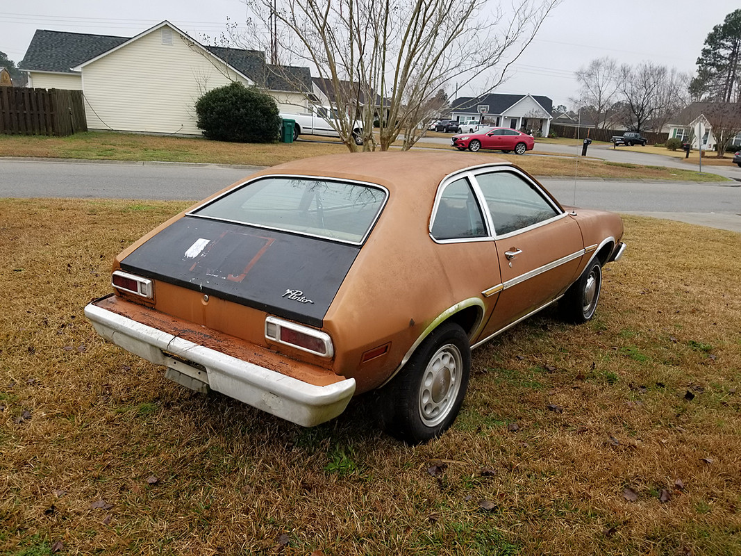

I played with this one for a little bit..
Big bumper, big tail lights,
to big bumper small tailights,
to small bumper small taillights.. I used a 67 Camaro rear bumper. It's like it was made for it. Now I just need a rear valance.

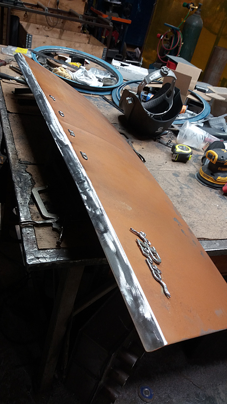

little rust repair on the original trunk... Just for fun.
Outside, not too bad, starting on the inside now

Yesterday I spent a little time on the rear of the car.
Moved the Camaro bumper up a bit. I had mounted it a bit lower than it should have been and it was bugging me.
I also fit the Mustang valance up a lot better. This will work.
Much better than the bookshelf that was hanging off the back before.

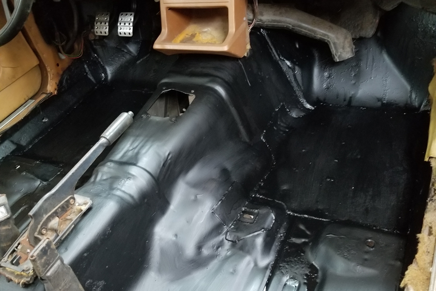

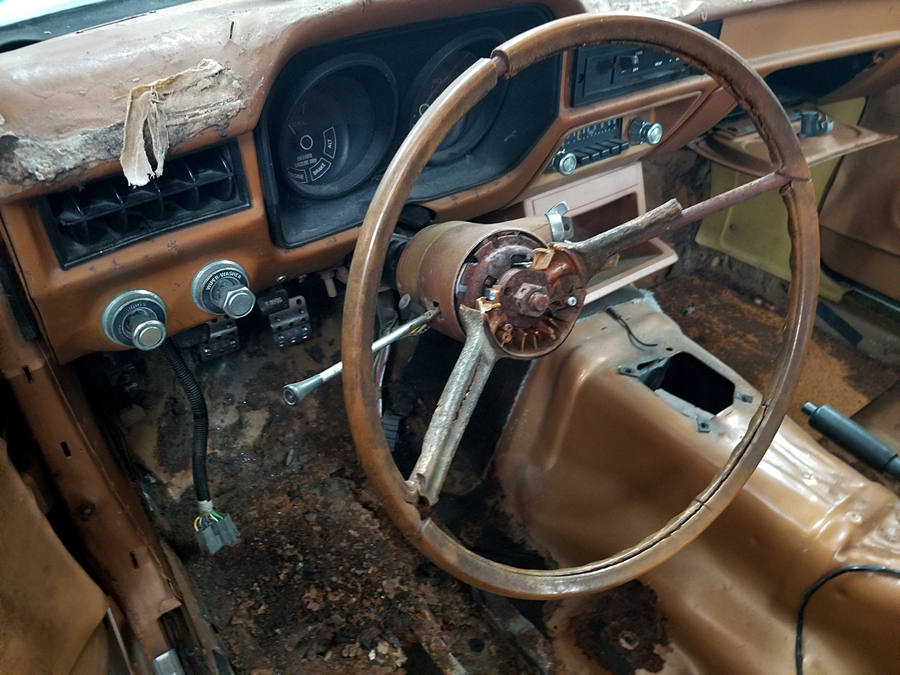

So, as clean as this thing is on the outside, it was horrible inside!!
Leaking cars, sitting outside since 99 will do that
Had a steering wheel in stock, and just bought a cheap speedway column.
The original rag joint was ripped in half, so good thing that is gone.
Also got the Wilwood pedals hung with both master cylinders.
I found a dash pad. Need to grab it before they disappear

I also had some issues with the floor.
Just cut it back and filled in with some stuff I had in stock.
It don't have to be pretty, its a Pinto, lol.
I did give it a heavy coat of Rustolium rusty metal primer, then paint.
I will throw down some sound deadening today. At least I won't be falling through the floor now.
