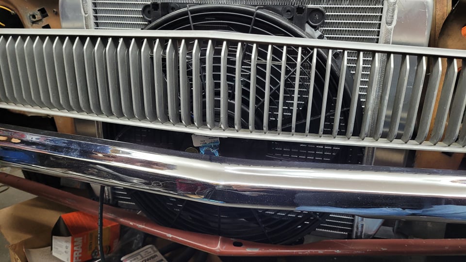

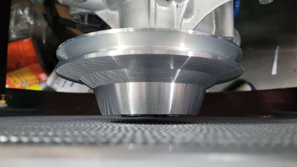

Today I ground the center of the waterpump down flush with the pulley and countersunk the screws..
Then notched the lower valance, so that the fan would fit
Then removed a bit of material on the back side of the grille
So that everything should fit
With TONS of room to spare.... going to have to remove the radiator to put on fan belt.. Glad I have solid motor mounts. lol

Yea....that's a bit tight man! Hopefully the solid mounts won't let it move forward much!

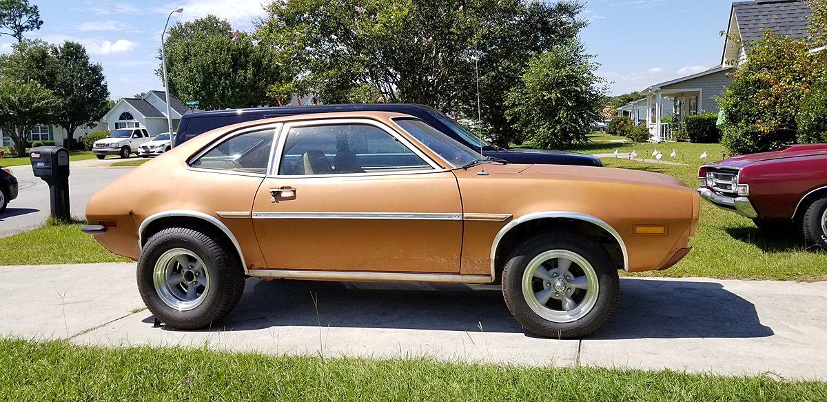

Sorry.. Lost a bunch of photos, and steps when the site here went down, but fast forward to 2 weeks ago.. Pinto moved for the first time under it's own power since 4/99
It has been off the road longer than it was on.
Sorry for the bad video, there was no one home and I was not waiting. Wedged the cell phone in the tire tread of the Jeep and went on my own.
Barely rolled on the throttle and instantly spun the tires. lol

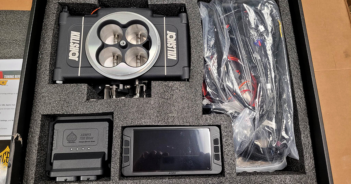

Ok... So, Killshot.
Installed the system, programmed initial setup. all good.
Start the car, screen goes black, then comes up with some weird lines.
Call Aces, talk to tech, they send a new ECU and handheld right out.
Install new ECU and handheld, and the exact same thing happens.
Worked fine for initial program, but this time as soon as I start the car, the screen
says that it lost communication with the canbus.
I can hook up my laptop through same canbus, and it communicates fine, running or not.
On phone with tech support for over 1.5 hrs.
Everything reads what it should, voltages check out, wiring is correct.
Checked in once a week later, they are waiting on info from CDI box maker..
another week goes buy, send tech a text, but this time, no reply.
Going back today... Stepping up to a sequential setup... This one better work!
