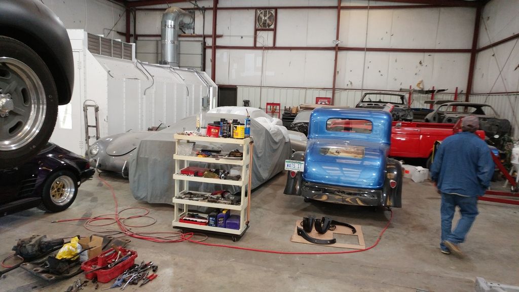

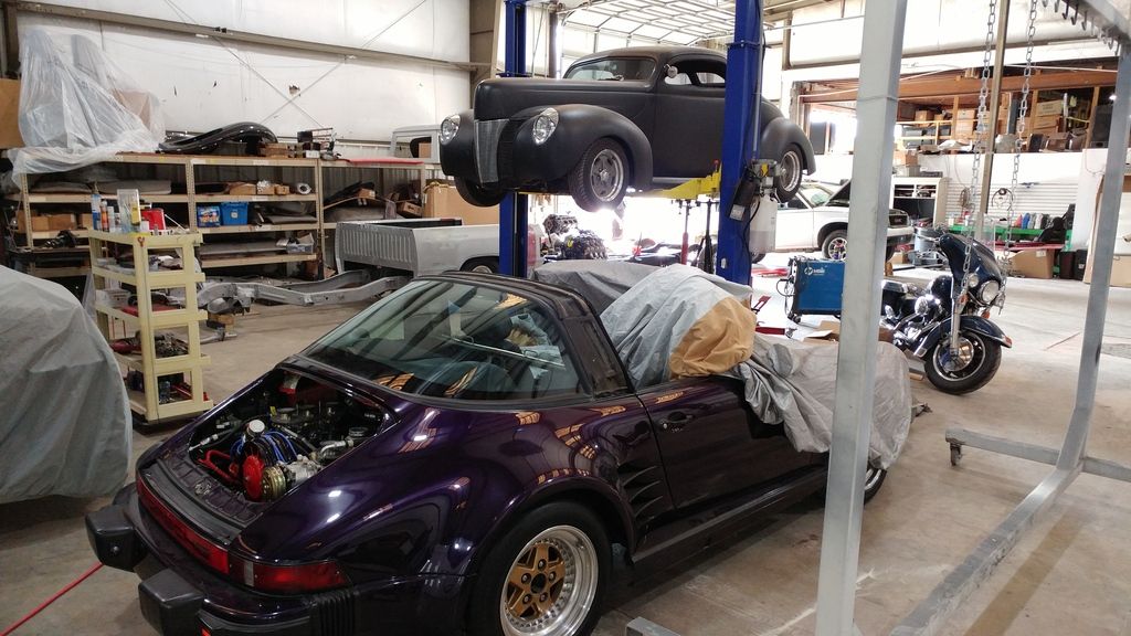

Made it to the guy's shop, lots of eye candy!
Painting a freaking helicopter!

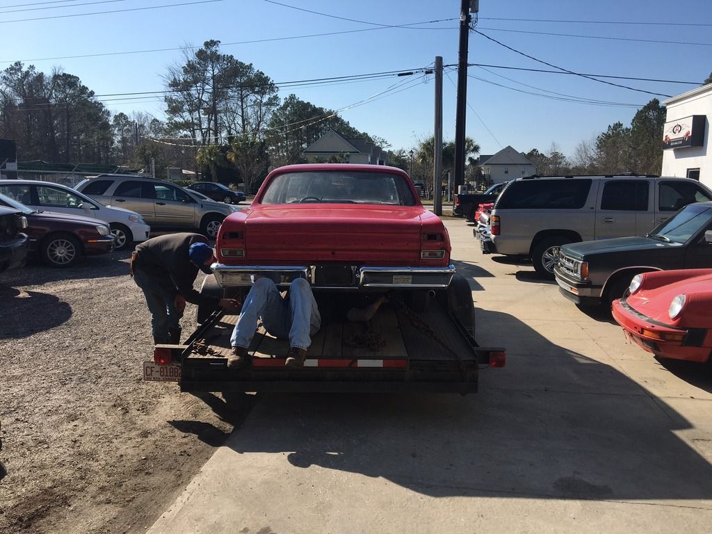

Get it on trailer, get to gas station.

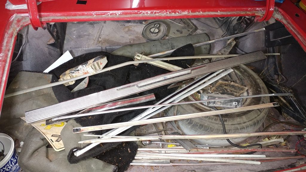

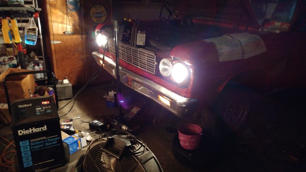

Go around pulling all loose lights, trim, emblems off so nothing falls off coming home (3.5 hrs). Door and fender trim held on by widdled plastic trees inserted in the back. Got it all taken care of, nephew arranged all the emblems on the driver's seat while I talked with a homeless couple admiring the car. You know you did ok when a homeless guy tells you you stole it.

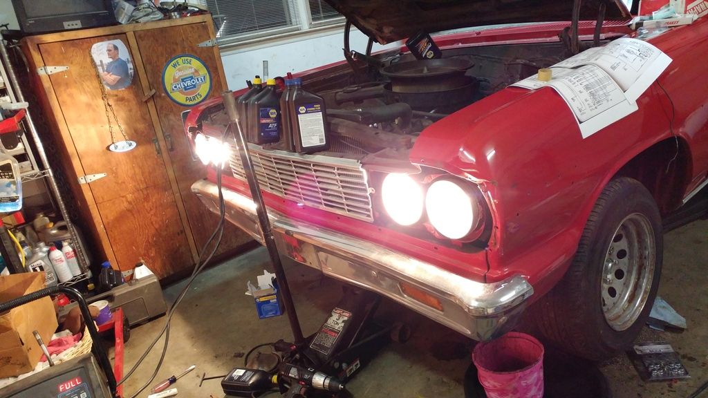

Get home late, dark out, everyone is ready to be done, no interior lights. I rush, hop in car, crush every emblem with my fat ass. Ok.. then car wouldn't start so we push it into the garage. I notice I can hear everyone behind the car clearly but don't think anything of it. Get it in the garage under lights.. no back window. Idiot just propped the rear window in the car, not a drop of glue or anything. Gouged the driver's fender on its way out too.
Battery was drained from trying to start with no gas, pop charger on it and it fired right up. Doesn't sound bad for a 305. Exhaust is crimped pretty good, has the old school high compression sound to it. Rear tail pipes are held on with plastic strapping.
Got a chance to get under it last night, took a minute to get it jacked up, and had a good laugh. First had to jack it up by the frame horn by the sway bar mount, damn thing is LOW.
There's an AutoZone somewhere cleaned out! Same look on the other side, actually splurged and had metal bolt style expanders on the back coils.

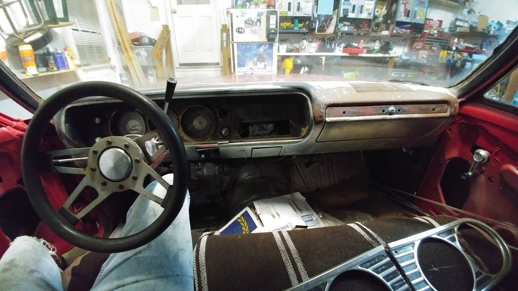

Driver's seat shot
Need to find the mfg of these synthetic hangers, they're crap!

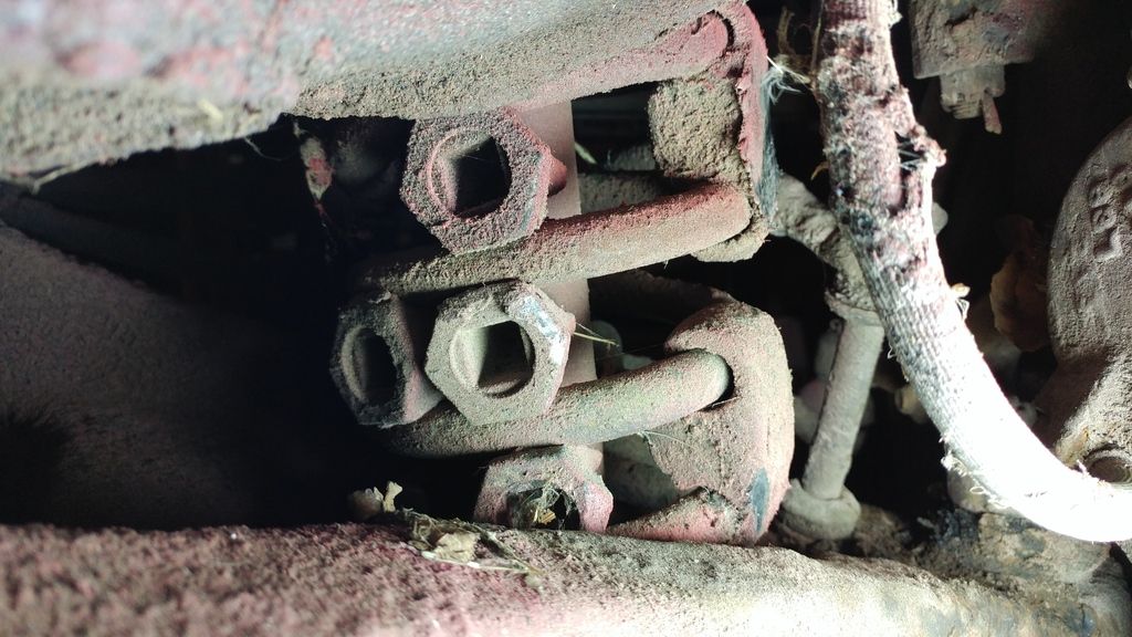

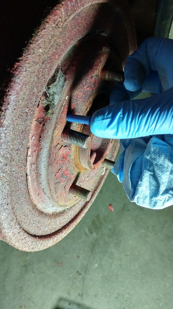

Drivers side "slotted" rotor, one broken stud, one lug finger tight, 2 different size nuts..
On top of the lug nut fun, check out the bearing action on this bad boy! Pass side shows just as much play. I'm extremely glad I didn't try to take this down the road.

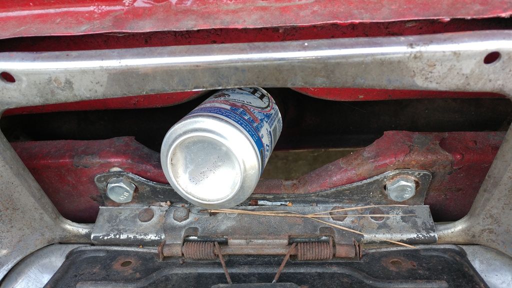

I'm fortunate enough to have found a car that was meticulously maintained. There's a grease zerk in there I'm assuming.

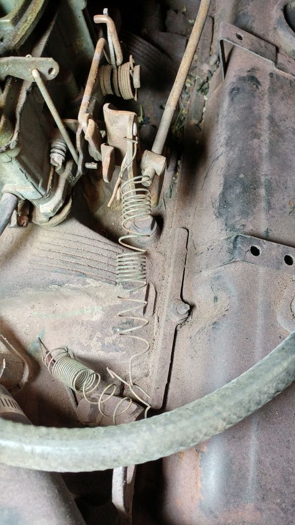

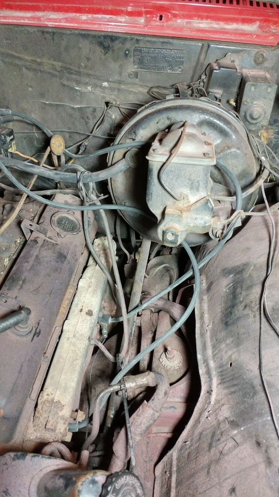

Wondered why it had a high idle, one spring wrapped around the engine hook, rusted in half.. twice..

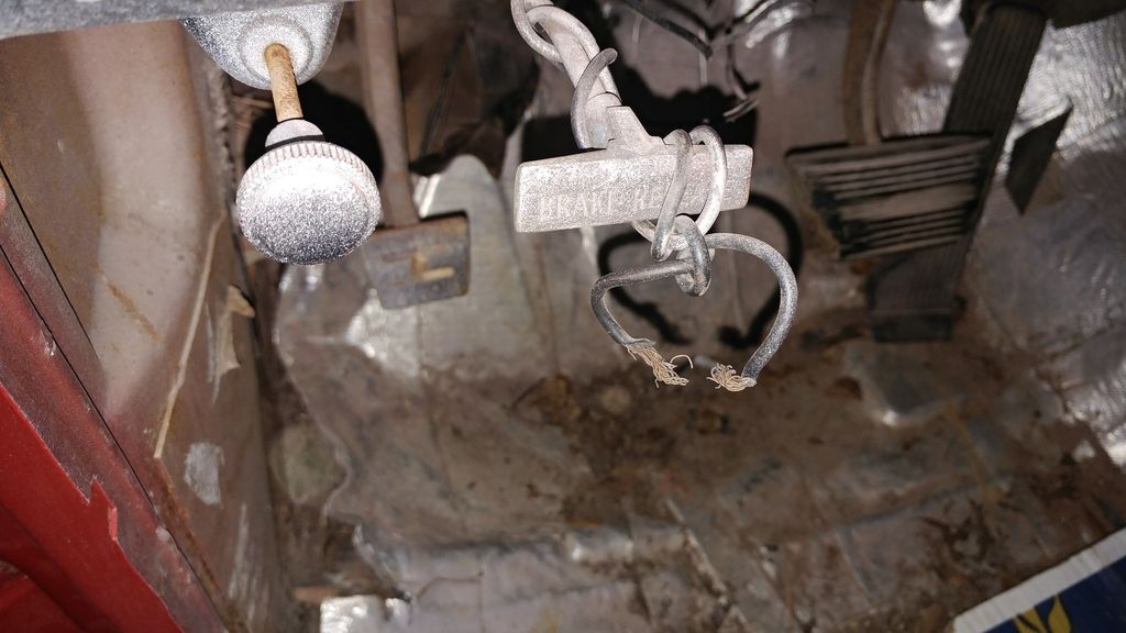

This one shows a couple.. wires going into the firewall through the ungrommeted hole is straight off the battery. It's normal to loop plug wires around your master, right? Check out the shock bushing and stack of shims, and you can just make out the o2 sensor in the bottom of the log (in between 3 & 5 plug wires).

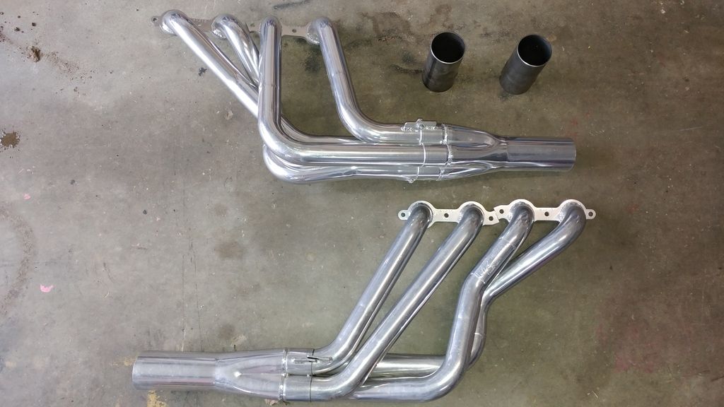

Dear Craigslist, I love you.

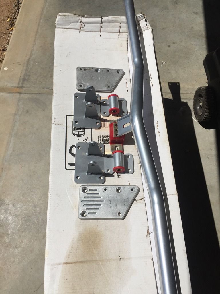

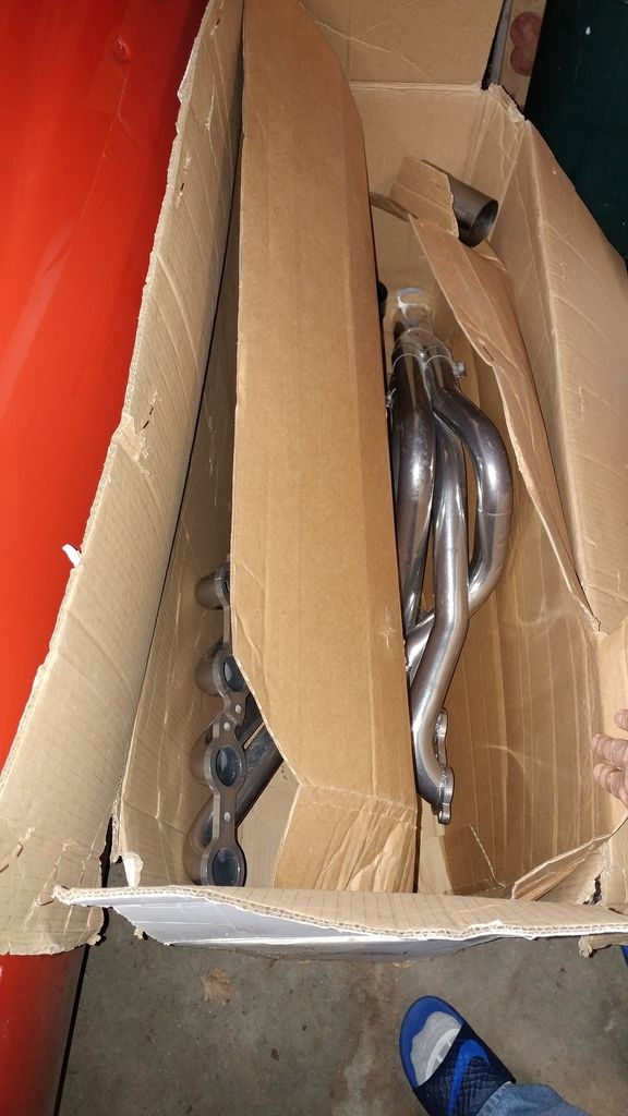

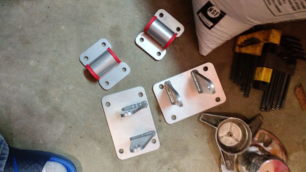

BRP Hot rods mounts
Trans cross member
And ceramic coated long tubes
Guy selling these was an awesome dude. His Chevelle was the test bed for Hotchkis suspension and was a centerfold car for Chevy High Performance in '07. Hoping to get his suspension when he upgrades in March.
On the downside I've done some reading on BRP stuff, sits the motor high. Hope I can modify them (not much invested so won't feel bad cutting them up) to work and the headers not bang into anything. Waited quite a while for my first set of longtubes. Fully stoked!!

Thanks, I've waited 25 years to finally get long tube headers, this is an achievement for me.
Forgot to mention the seller of the longtubes has a crazy LS setup in his car with a NASCAR type front end/accy. Weird water pump, Ford distributor, etc. He had to push the engine so far back he couldn't use this setup. Oh, he also designs and manufactures the shocks that Detroit speed sells.
He was advertising the headers, I contacted him and he told me about the swap stuff, made a killer offer then packed up the fam and laid the ears back.

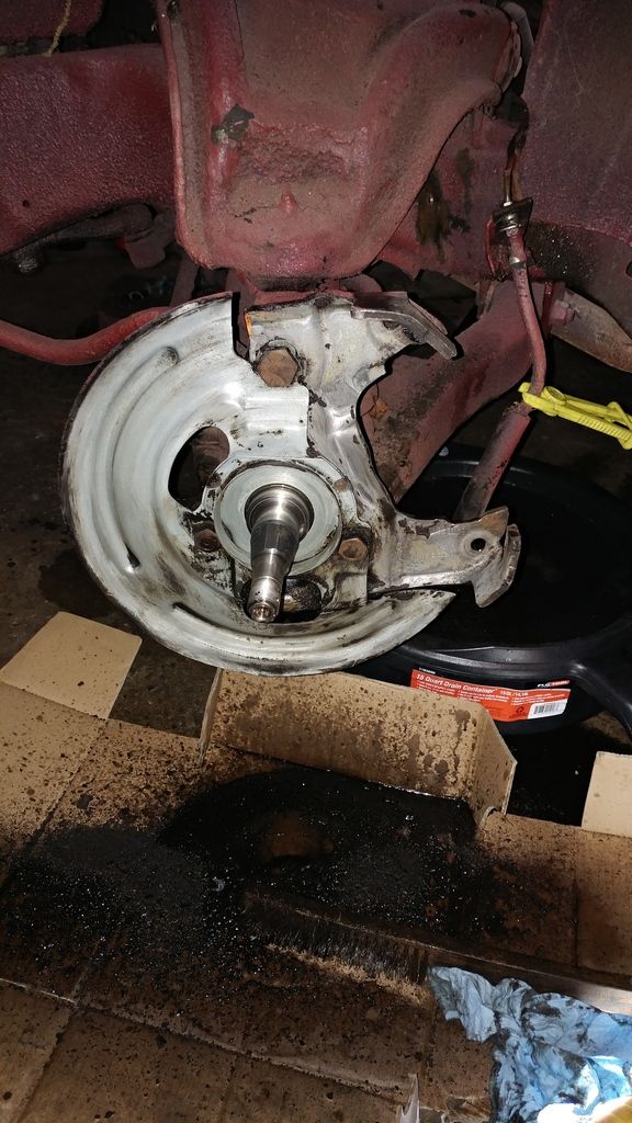

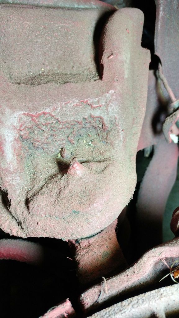

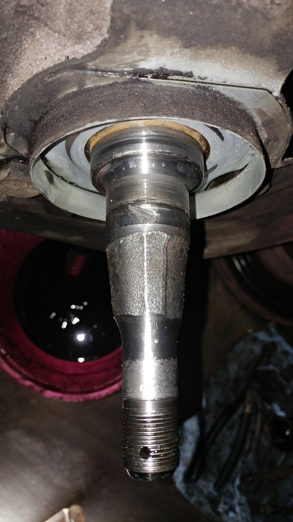

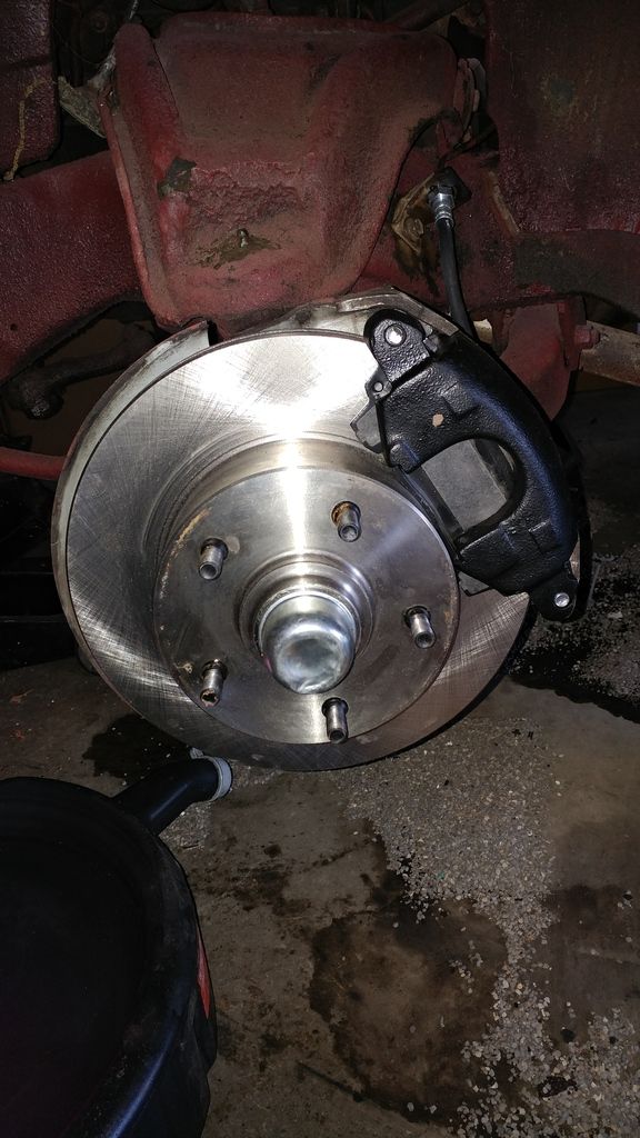

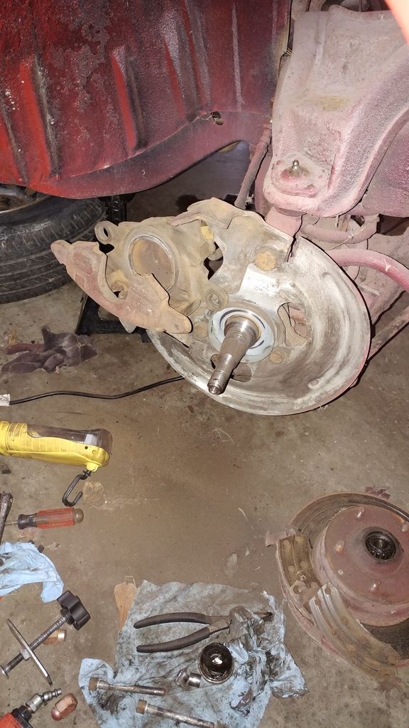

On to pics, worked on the front brakes but got no where. Drivers caliper frozen, wrong seals, etc.

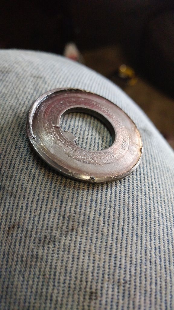

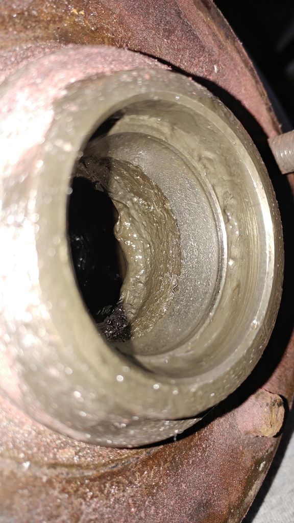

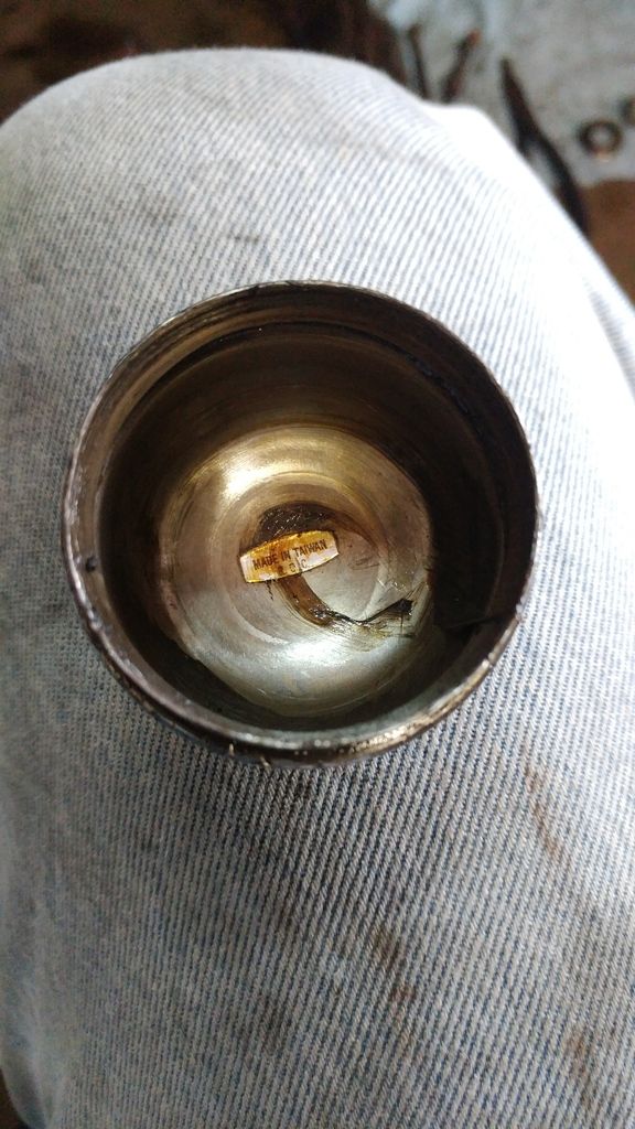

Drivers outer race, didn't care to check inner, knew it needed to be replaced, besides the rotor being trash
File 13, trying to keep China away from this build, although all the bulbs I just got from Napa have it proudly stamped on it.
Rotor was cocked so far it rested on the washer, deforming it and rolling the edge over

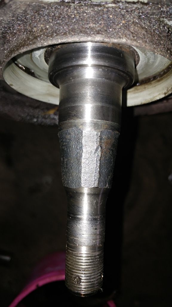

Drivers spindle, not best of shape but useable
Pass spindle, looks like race was cut off or chiseled off in the past, same shape as driver side
How it sits. Removed as much crap from shield and caliper, have at least 1/8" covering on floor. You can see how black the grease was in the old rotor, it was liquid nasty.

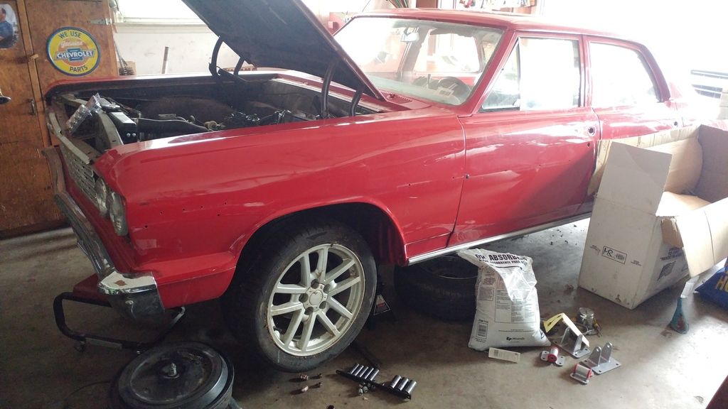

Trans and engine mounts minus billet plates
Test fit with the broken rim, these might actually fit

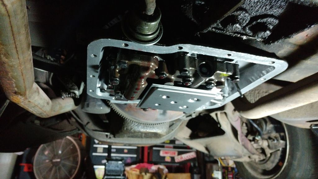

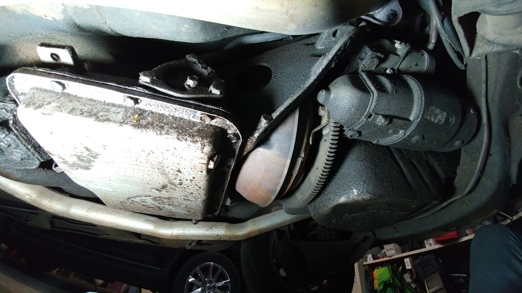

Driver's side before and after, didn't go all out, not really concerned with looks at this point, just wanted the major chunks off

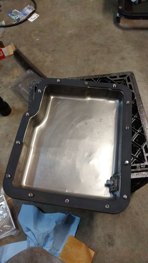

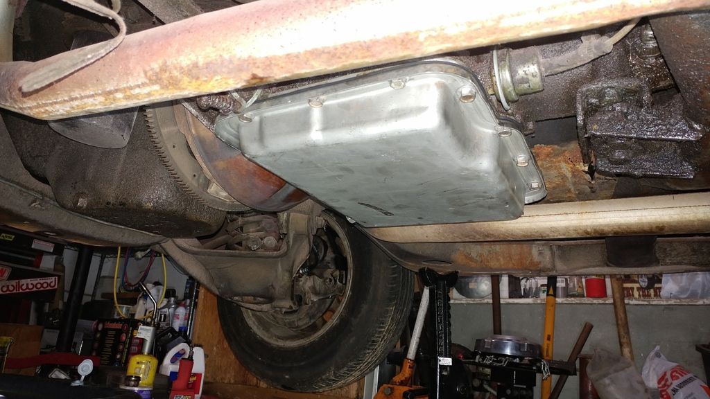

trans pan was leaking, figure cheap filter/gasket change. Now I'm wondering if this thing has 2nd gear
cleaned up
filter is nothing but screen/mesh
Buttoned up

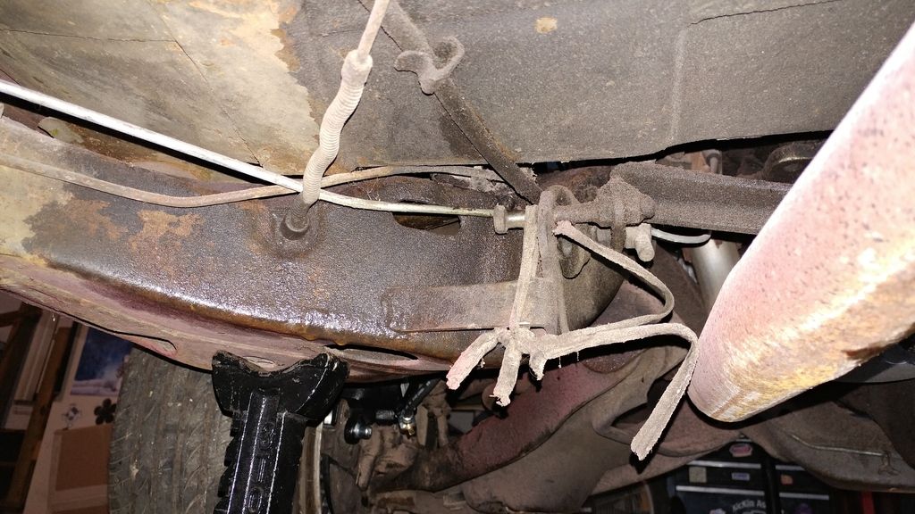

This brake line had me laughing my ass off. Only thing I can come up with is no flaring tool so they did what they could w/ the extra length. All the bleeders are mangled w/ visegrip marks.

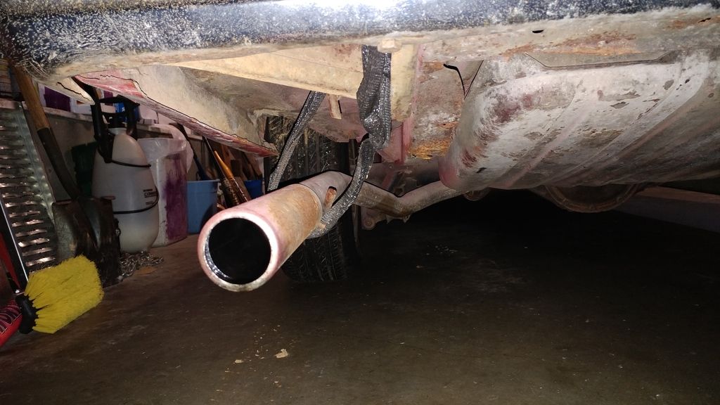

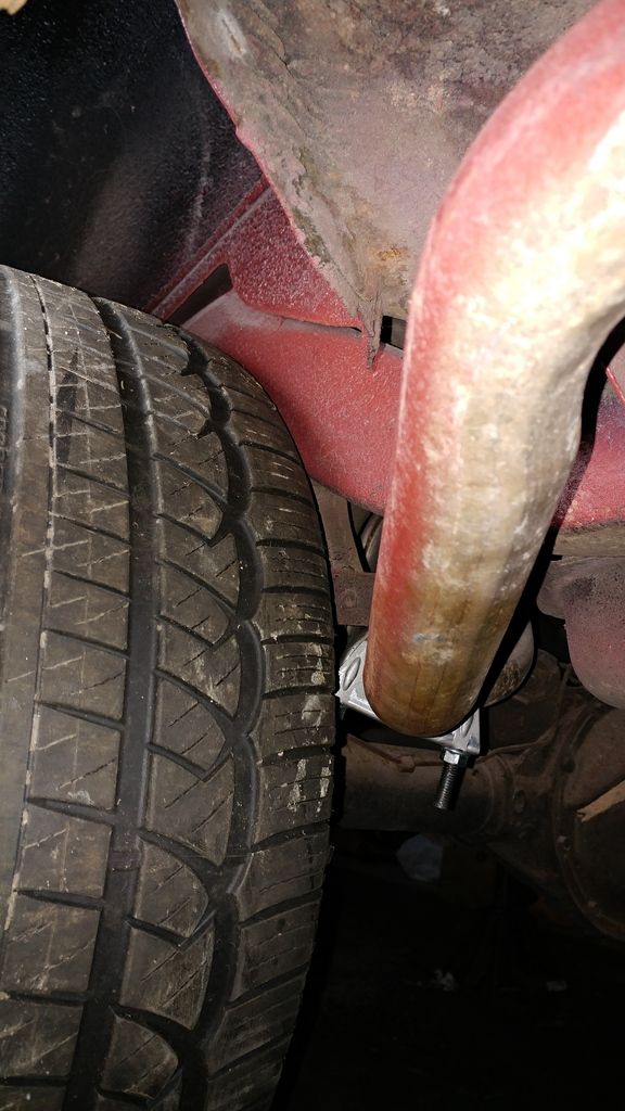

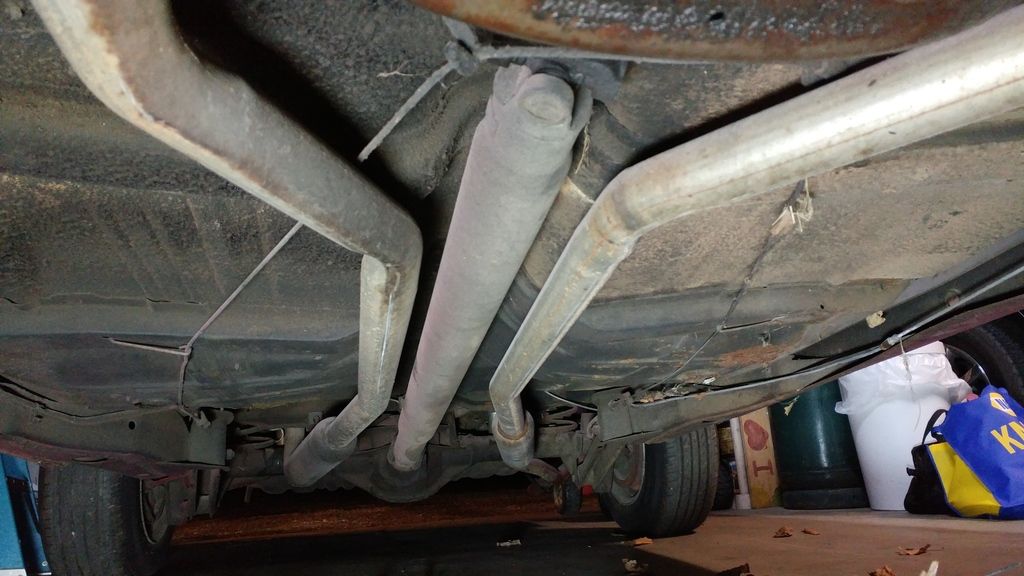

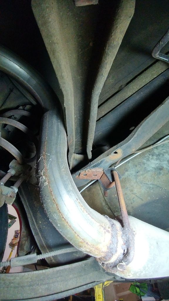

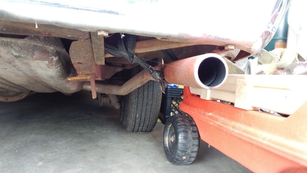

driver's pipe is seriously hitting the rear lower control arm
Found out the exhaust is 2" pipe, crimp bent, reason the 305 sounds like a 12:1 350..

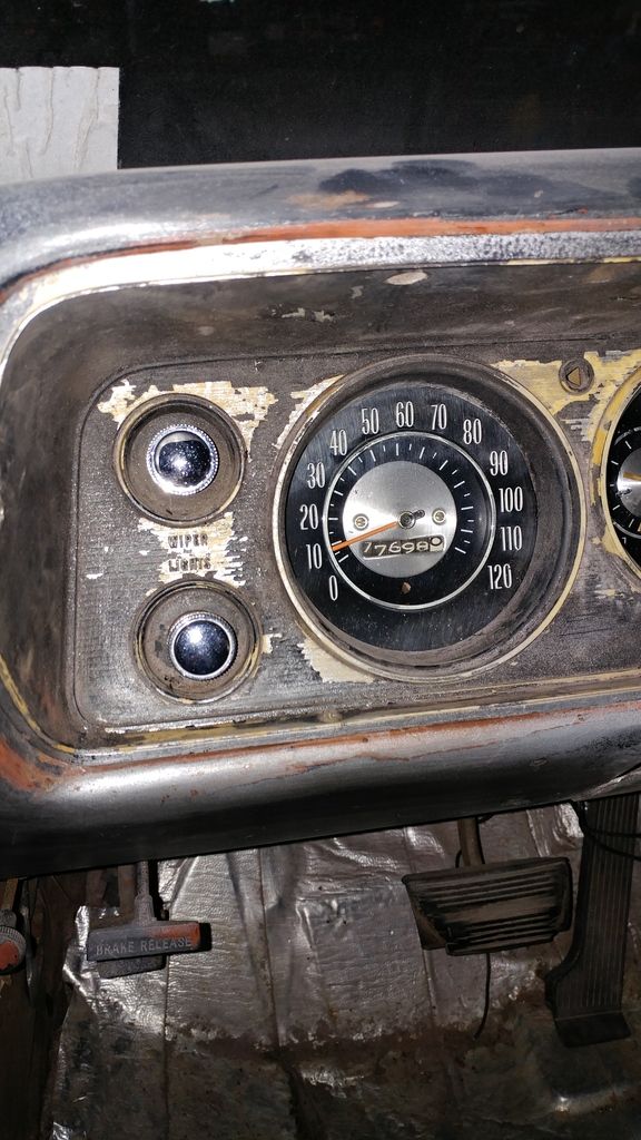

Buddy and I had bets on this being the horn but I think it's the wipers, still trying to track the wiring down, it goes down to the headlights, taps into factory harness, then goes back to behind the booster and taps into a different harness. f'ed up. bare wire twisted all over.
I'm about numb to things like this now. shoestring on the shifter linkage.

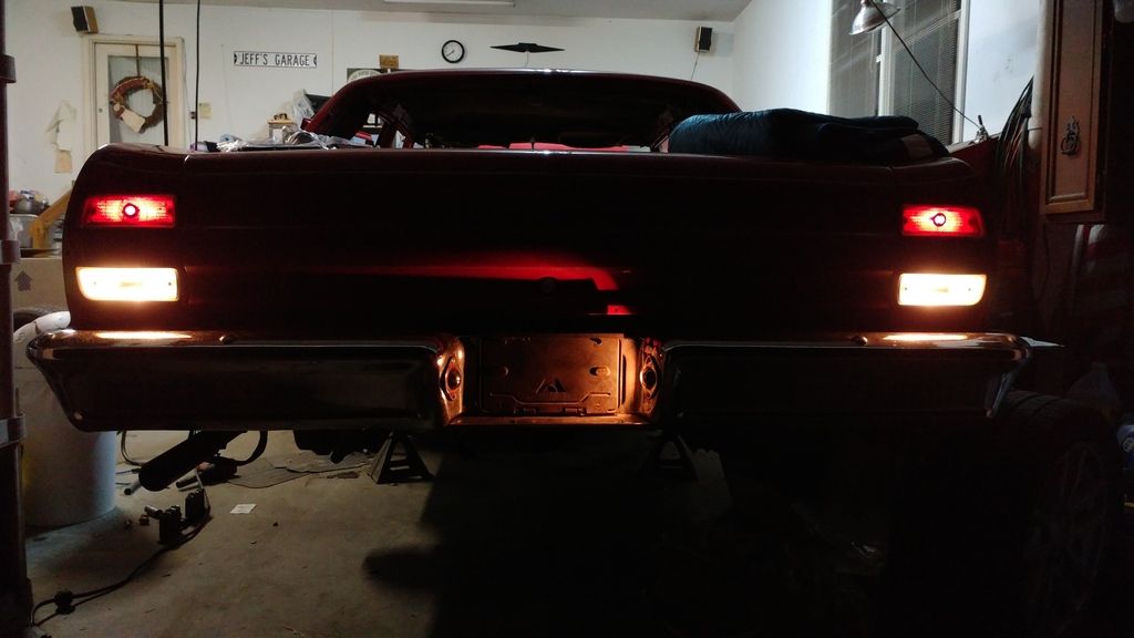

Made a Napa run, replaced all the bulbs in the dash, and cleaned all the ground connections. Nice results, will have to pick up some orange needle paint to refresh the gauges.
This is damn sexy.
I'm not really surprised that all 4, yes 4, headlights were blown. Checked connections, wiring, voltage, and grounds. All 4..
Replaced the bulbs, ditched the eyebrows, and noticed I had parking lights until I turned the headlights on then the front parking lights went out.
Did some googling, and found it's a 64-67 "feature". 68 lights stay on. Moved the front parking lights wire to an unused slot mimicking 68 wiring on the headlight harness following internet and now they stay on.
The reverse light switch is not working, wired in a cheap light up duck bill switch under the dash. It'll stay till the drivetrain is swapped as it's not worth investing. It's ready to come off jack stands and go down the road.

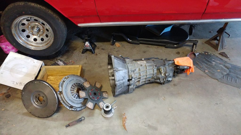

Getting real round here! Bellhousing came in, only thing lacking is bolts to keep it all together!
Blub blub tick blub tick bulb. Pass manifold has a leaky heat riser valve that seals up once it's warmed up. 20hp lid flip FTW!

I was hoping they wouldn't look bad. Main reason for wanting to run them is I have a set already. If I do end up running them I want to spray them the greenish/gunmetal color that's on the rallies.
dat ass! Driver's license plate light needs a new receptacle. The spring that pushes the pin into the bulb center conductor is rusted out. I love the lenses though, they're little ufo shaped, thick, glass domes. Little rubbing compound had them looking brand new.

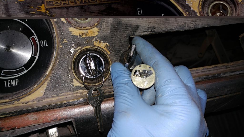

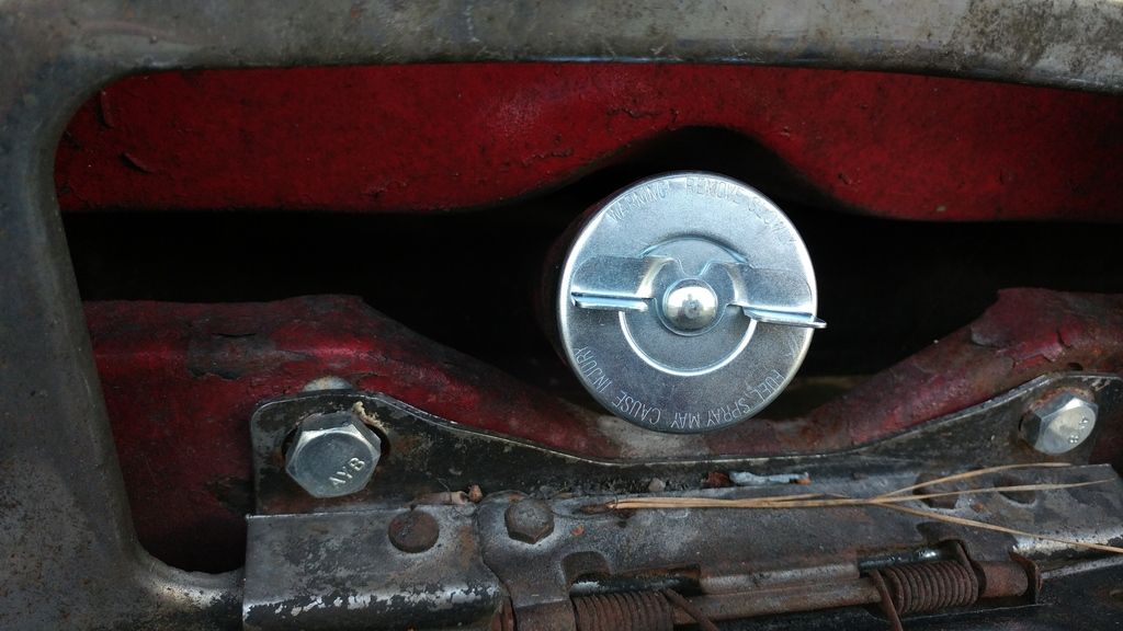

mangled lock with 1/8" drill to pop it out and get new ignition lock installed, gone in 60 minutes.
Not looking forward to figuring out what I got, what I need, cleaning, straightening, installing, etc.
Test fit the SS rim on the rear. Initial thought, 1 - 1.5" spacer may work. Might require BFH assistance, but I may actually be able to run them. Might be necessary to knock down the tire size to 255, really don't want to go that route though.
these studs kill me. that's the length vs a blue butt connector. Tried installing the rest of the new lug nuts I purchased but the threads are so mangled half wouldn't even start. I just put the old ones back on for now, they dragged so bad going on.

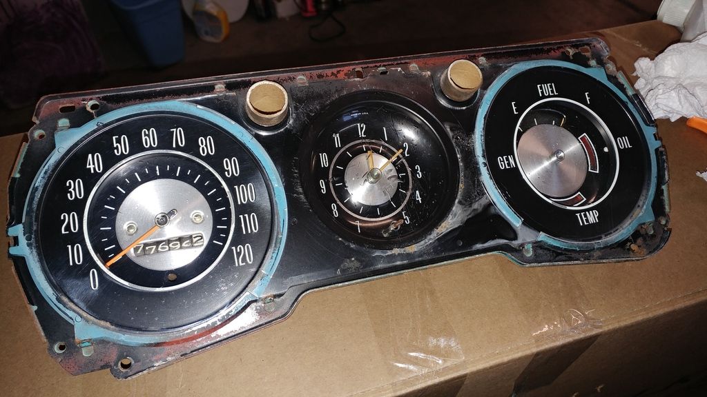

Awesome night!! Maiden voyage done, instead of quenching the fires it's just stoked them! Car drives decent, powerglide works, I was like a little kid driving a go cart for the first time. Permagrin.

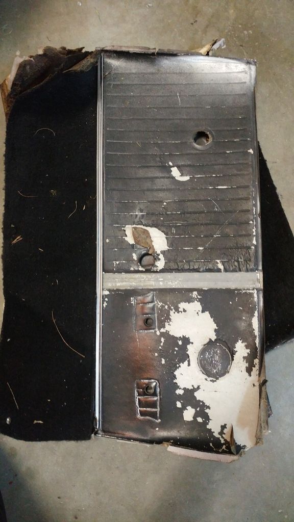

Finally pulled the door panels out, they're complete trash. $350.. That's down the road.
Never got a pic of the finished brakes. Feel bad that I pounded this new cap in, was a really tight fit, ended up v'ing the lip so it would compress and fit, still seals like it's supposed to. And the brakes work really well. Unbolted seat, no seat belts, and those brakes led to a 3 stooge scene starring me.

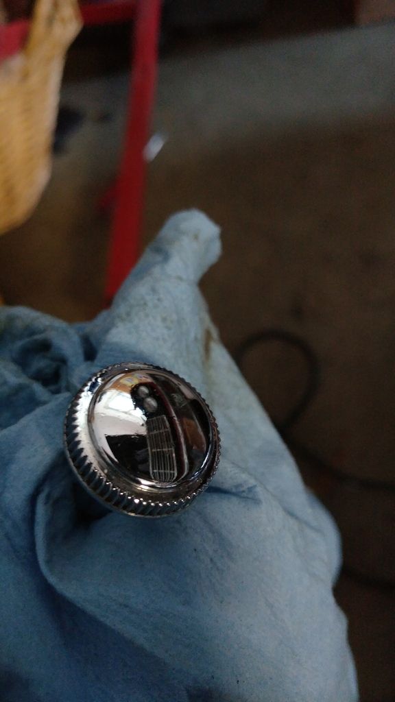

Both headlight and wiper switch looked like this, completely nasty. Wd40 and 000 steel wool worked wonders.
Installed

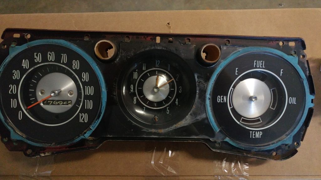

Car came with a new bezel, waiting to install it. Got to get through theft inspection, title, then there'll be fab work on the trans tunnel and floorboards, then it'll get some love.

Did you ever find out what the magic wires were on the brake release? Confirmed they were the wipers? That was my favorite nest egg you've found so far.
